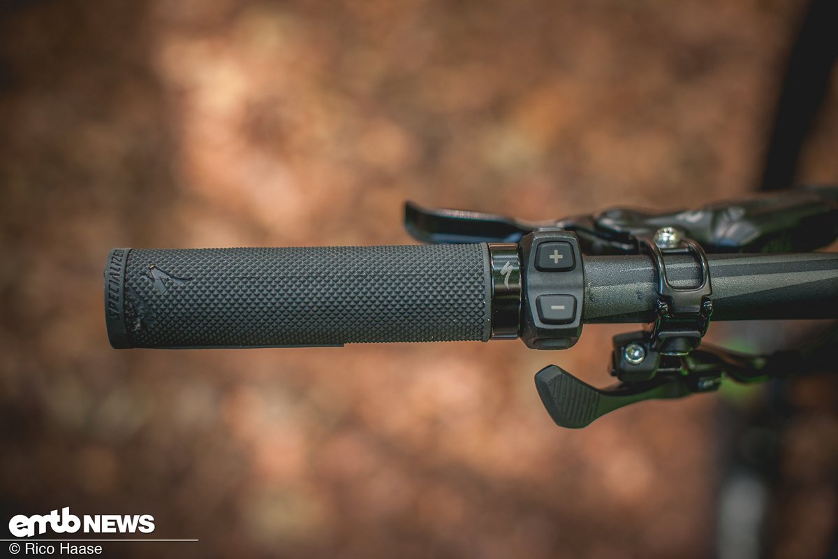

| Lenkerfernbedienung | Trail Handlebar Remote, motor mode switch & walk-assist |
