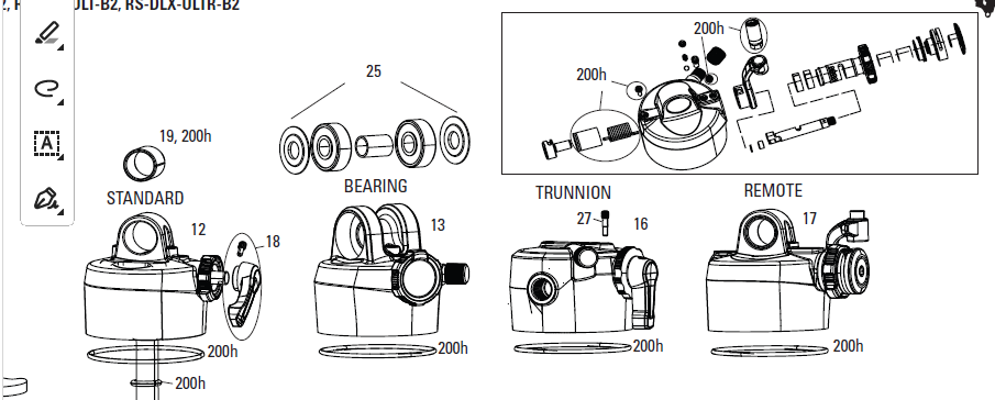

Für mich sieht es eher so aus, als wenn für den einfachen 2023er Deluxe R kein Ersatzteil vorgesehen ist.
DELUXE AIR C1 (2023+)
EYELET
10 11.4118.073.008 REAR SHOCK EYELET ASSEMBLY - (INCLUDES EYELET, AIR VALVE AND CAP, CONTROLS, SHAFT O-RINGS)- DELUXE SELECT (C1) 2023+, STANDARD
10 11.4118.073.010 REAR SHOCK EYELET ASSEMBLY - (INCLUDES EYELET, AIR VALVE AND CAP, CONTROLS, SHAFT O-RINGS) - DELUXE SELECT PLUS (C1) 2023+, STANDARD
10 11.4118.073.013 REAR SHOCK EYELET ASSEMBLY - (INCLUDES EYELET, AIR VALVE AND CAP, CONTROLS, SHAFT O-RINGS) - DELUXE ULTIMATE (C1) 2023+, STANDARD
11 11.4118.073.009 REAR SHOCK EYELET ASSEMBLY - (INCLUDES EYELET, AIR VALVE AND CAP, CONTROLS, SHAFT O-RINGS) - DELUXE SELECT (C1) 2023+, TRUNNION
11 11.4118.073.011 REAR SHOCK EYELET ASSEMBLY - (INCLUDES EYELET, AIR VALVE AND CAP, CONTROLS, SHAFT O-RINGS) - DELUXE SELECT PLUS (C1) 2023+, TRUNNION
11 11.4118.073.014 REAR SHOCK EYELET ASSEMBLY - (INCLUDES EYELET, AIR VALVE AND CAP, CONTROLS, SHAFT O-RINGS) - DELUXE ULTIMATE (C1) 2023+, TRUNNION
12 11.4118.073.012 REAR SHOCK EYELET ASSEMBLY - (INCLUDES EYELET, AIR VALVE AND CAP, CONTROLS, SHAFT O-RINGS) - DELUXE SELECT PLUS (C1) 2023+, BEARING
12 11.4118.073.015 REAR SHOCK EYELET ASSEMBLY - (INCLUDES EYELET, AIR VALVE AND CAP, CONTROLS, SHAFT O-RINGS) - DELUXE ULTIMATE (C1) 2023+, BEARING
Laut Sparecatalog passt keiner zum Deluxe R und 2017-2022er Teile sind soweit ich weiß nich kompatibel.
