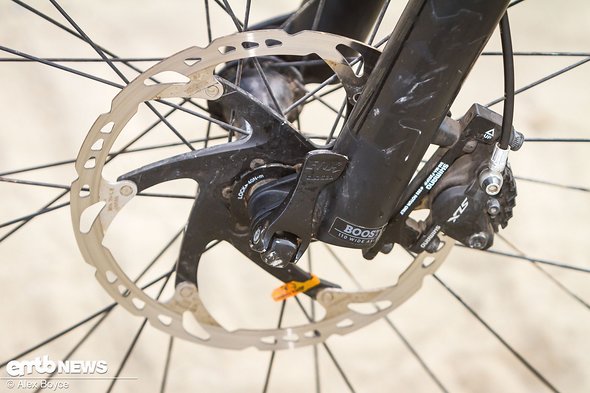

Die vordere Bremsscheibe ist in einem super Zustand und auch die Bremsbeläge werden noch einige Kilometer halten.

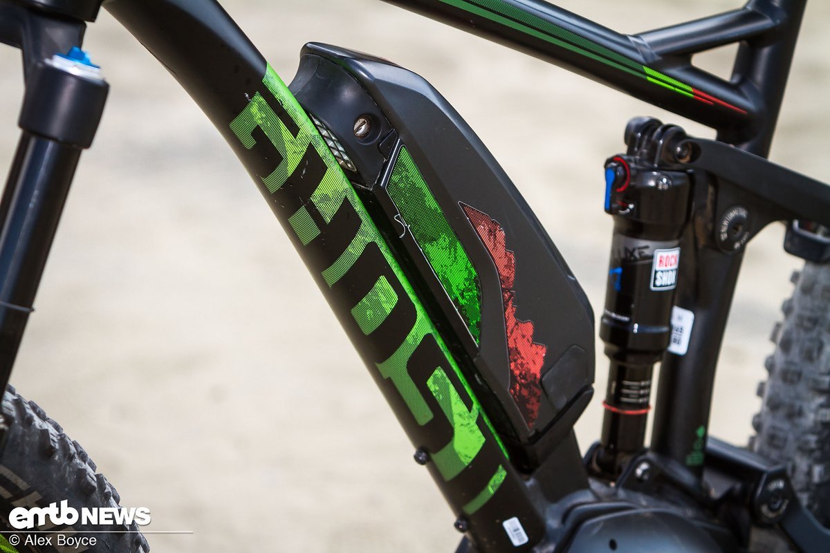

The battery has remained connected the whole time, there is zero play in the mounting system. The charging unit flap is still intact.
# The battery has remained connected the whole time, there is zero play in the mounting system. The charging unit flap is still intact.

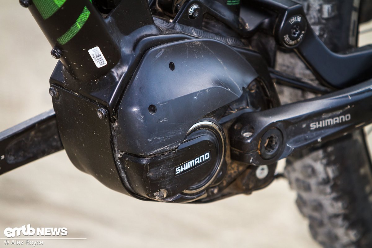

The bash plate did not have to do much of a job.
# The bash plate did not have to do much of a job.

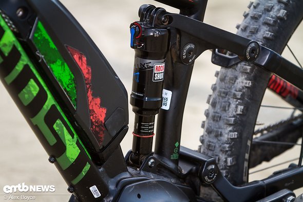

The rear shock is still smooth and progressive. It retains its small bump sensitivity
# The rear shock is still smooth and progressive. It retains its small bump sensitivity - soon we would like to do a service on the unit.

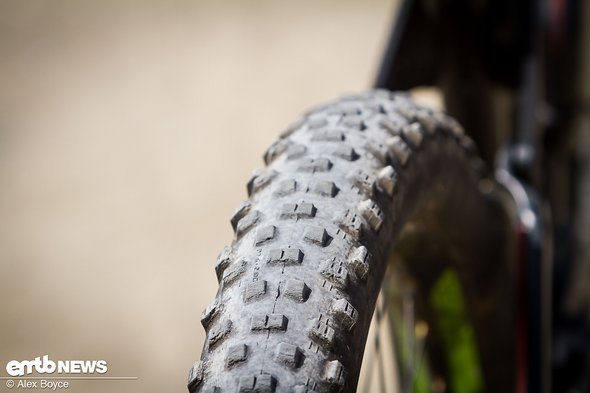

Wear on the tyres has been pretty good: The front is still in good condition, the back needs replacing. The effect of this on performance is basically that it’s more of a drift machine in corners now.

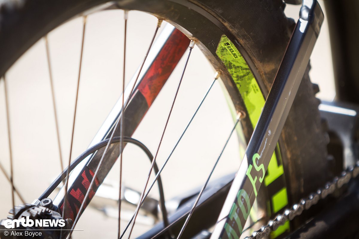

Spoke tension is still good
# Spoke tension is still good - we have not touched anything on the wheels despite the abuse we have given them.

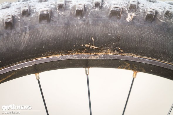

The rear rim is dented in a few places, fairly normal for the type of riding we have done.
# The rear rim is dented in a few places, fairly normal for the type of riding we have done. - The wheels still hold air tubeless and also are still true.
The rear tyre has signs of wear. After 1500 km it is time to change it as grip in corners on loose surfaces is reduced.
# The rear tyre has signs of wear. After 1500 km it is time to change it as grip in corners on loose surfaces is reduced.

The Shimano SLX brakes have performed effortlessly. We have not needed to bleed the brakes – performance has remained consistent throughout the testing period. We have now noticed that the rear pads need replacing and the rear disc would benefit from being changed. We think that the brake power and specification is ideal for this type of E-Bike. We have never been lacking in power.
The front disc is in excellent condition, the brake pads still have a quite a lot of runs left on them.
# The front disc is in excellent condition, the brake pads still have a quite a lot of runs left on them.

  • Tyres are not aggressive enough
