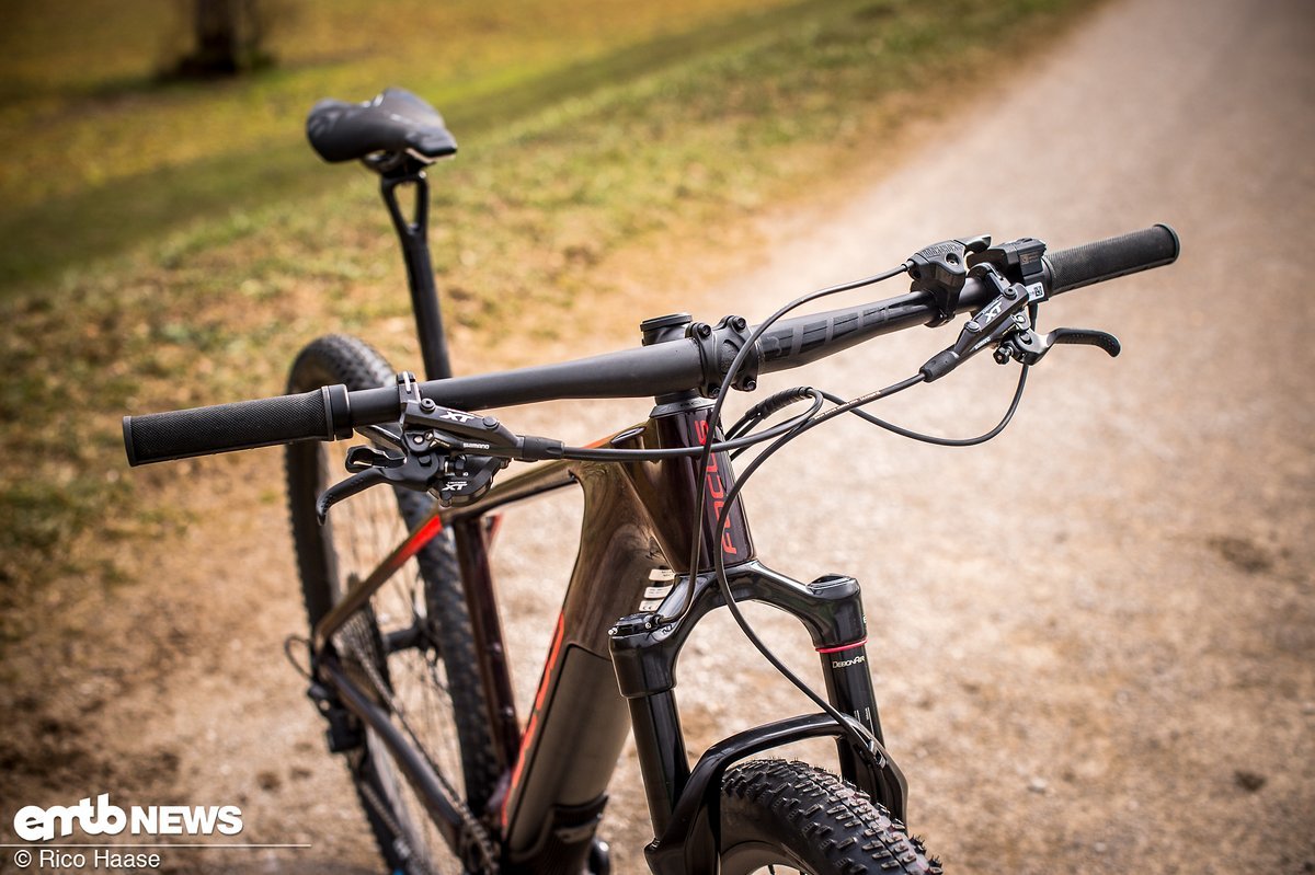

BarLenkerBBB, carbon, flatbar, 720 mm, rise: 0 mm, backsweep: 9°
StemVorbauBBB Race, aluminium, 31,8 mm

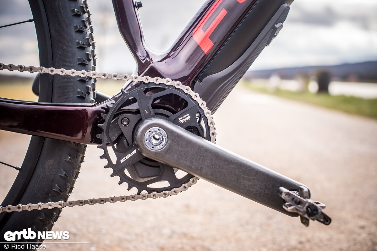

The compact Fazua Evation 1.0 motor weighs just 2 kg and is neatly integrated into the down tube thanks to its compact dimensions. The 252 Wh battery and lightweight motor are packaged into a cylindrical unit, which – if desired – can be completely removed from the E-Bike. Unlike the other torque-monsters on the market, the Fazua produces only a nominal 60 Nm of torque, which is noticeable out on the trail. The motor engages smoothly, works silently and is not intrusive on your riding at all. Sporty riders will love how this motor behaves – eBikes have never felt so natural. Over the 25km/h assistance limit this motor continues to be a joy to ride, with no pedalling resistance at all. The capacity of the 252 Wh battery is relatively small, though it does only weigh just under 1.5 kg. That lets you carry a spare battery in your rucksack easily.
The Fazua Evation motor is so small, that it can hardly be seen behind the direct mount chainring.
# The Fazua Evation motor is so small, that it can hardly be seen behind the direct mount chainring.

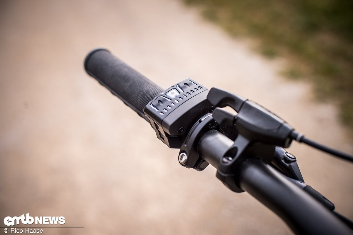

The remote unit is intuitive to use and provides feedback about the chosen power mode and battery charge with coloured LEDs.
# The remote unit is intuitive to use and provides feedback about the chosen power mode and battery charge with coloured LEDs.
The handlebar mounted remote is easy to actuate and the assistance mode is identified by its corresponding colour. Green – lowest assistance level (75%, 125W), Blue – mid-level assistance (150%, 250W), Pink – highest assistance mode (240%, 400W), White – no assistance.

  • Mini disc rotors Whilst smaller rotors, especially on such a tuned E-MTB, help to save some weight, we don’t think it’s worth it. Small disc rotors don’t have a place on E-Mountainbikes and we would recommend fitting larger ones.
  • Narrow bars The 720 mm carbon flat bar is too narrow for our liking. Steering requires a lot more input and it feels a little “claustrophobic”. Wider bars would improve the handling here.
  • No dropper post Just fit a dropper!
  • Small battery capacity This cuts both ways, but we still feel we ought to mention it. The compact battery has a capacity of only 252 Wh. Obviously that means that it is a small and lightweight unit, but it also means significantly less range for those who ride with more support from their motor.
The cockpit is nice and clean, but the 720 mm narrow bars and lack of dropper post impact negatively on the performance of the Focus Raven² 9.9.
